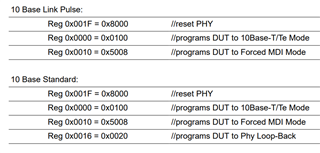

I would like to do 10Base-T compliance test with DP83869EVM.
I was able to output a 10Base-T test signal after reading the following linked document.
https://www.ti.com/lit/an/snla239b/snla239b.pdf?ts=1643690699825&ref_url=https%253A%252F%252Fwww.google.co.jp%252F
To evaluate 10Base-T compliance test, three types of signals must be generated.
・Link Pulse
・MAU(Media attachment Unit)
・Random Data(TP_IDL)
Link Pulse signal can be generated by EVM, but other signals cant be generated.
How can I generate other signals with EVM?
