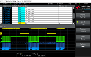

A. We are currently working on the following hardware configuration:
-ECU connect to de-serializer 934
-Image sensor (0x10) connected to 933(0x58) on the other  side
B. Problem
We observe that a single byte read from serializer is redding an undefined value if the 2 parts I2C read transaction ( WR to set register address and RD to get back register value) are separated by register write commands( to the sensor).
Please refer the logic analyser capture shown below. Read transaction with serializer (58W + 58R) is split by the high priority sensor (10W) transactions. Expected value is 0x11 (returned during uninterrupted/atomic read) but 0xF8 is read which seems to be a random value unrelated to the register address previously requested.
So questions are:
-Is interleaved register read command to the serializer a legal transaction?
-What could be the reason for the problem
-Is there any configuration to the back channel we should look at?

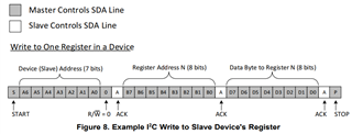

  • Hello Tri,
    If the ECU Master wants to send an I2C command to the Image Sensor, then the 934 DES will receive it on the local I2C bus, send it to the connected 933 over the cable link, and then the 933 will re-create the pulses on its local I2C bus. The 933 will also transmit the ACK bit back to the 934 I2C bus, to complete the I2C transaction.
    Below is another reference App Note about the I2C bus:
    https://www.ti.com/lit/an/slva704/slva704.pdf
    Here is an image from the App Note that discusses the sequence of pulses sent for an I2C read command that follows standard I2C protocol:
    Are you saying that if your ECU is in the middle of sending the I2C bits for a Read Command (Slave Address + Register Address + Slave Address + Data Byte), your ECU may interrupt and instead start sending a higher priority I2C Write Command instead?
    For example, say your ECU is in the middle of the I2C Read Command (Slave Address + Register Address), but then the ECU suddenly decides to do a higher priority I2C Write Command (Slave address + Register Address + Data Byte), before continuing to send the last 2 bytes in the previous I2C Read Command (Slave Address + Data Byte)?
    The end result is that the result of the I2C Read is some invalid value?

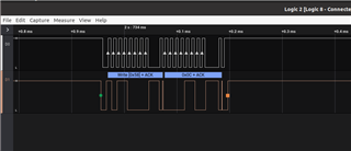

  • Hi Justin
    Thanks a lot for your support.
    Just to share some more capture of the bus in the failure case ( all these capture are on the I2C bus between the ECU and the 934)
    1. Register address WRITE to the serializer (0x058) and interleaving WRITE to the sensor
    0x58 Address WRITE and the WRITE to sensor
     2. READ from the serializer (0x58) which return invalid value
    All the transactions look pretty normal and follow the standard ( as stated with the application note that you have shared)
    Thank you,
    Kind regards,
    Tri

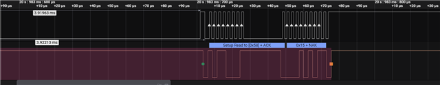

  • Dear Justin
    The 2 pictures above are 2 parts of the failure case. ( To make all the transitions readable we zoomed in and captured into 2 photos)
    In 1. you could see the 0x58W at the beginning, that is first part of the serializer read ( Set register address for reading). And then this is interrupted by multiple WRITE to the sensor
    And 2. shows the serializer's register reading is resumed with 0x58W after all the WRITE to the sensor are done. The invalid value we got back in this capured it 0x00 ( we expected 0x11). The invalid value is quite random
    Kind regards,
    Tri

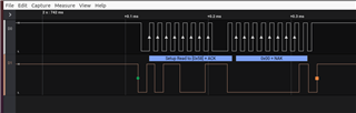

  • Dear Justin,
    I'd like to share some more photos of the failure transactions.
    1. The whole failure case, start with WRITE to the serializer, interrupting WRITE to the sensor and a READ from the serializer
    2. Zoomed in WRITE to the serializer
    3. Zoomed in  Sensor WRITE
    4. Zoomed in Serializer READ
    Please let us know if you need more captured data.
    Tri
  • Hello Tri,
    Thank you for the clarification. I will post again once I get a response from some internal design engineers in our team, but feel free to request an update on the situation.
    Justin Phan
  • Hello Tri,
    I was able to get a response. This type of I2C interleave transaction is not supported across the FPD-Link channel. While this is allowed in normal I2C protocol on a local bus, when you send I2C commands across the FPD-Link channel, the I2C commands must be complete and uninterrupted. You cannot interleave different I2C commands between the bytes in an existing I2C command and expect the existing I2C command to complete properly.
    Our FPD-Link devices re-create the I2C transactions from the local I2C bus and send them to the I2C bus on the connected device, but the STOP command bit in the middle I2C Write transactions will trigger the Back Channel logic to end the I2C pass through transaction, effectively cutting off the original I2C read command.
    Justin Phan

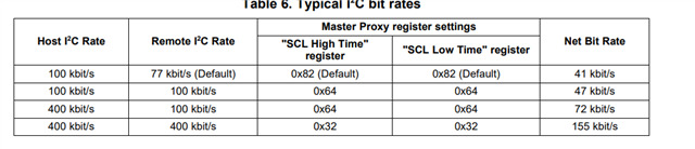

    The I2C latency of the READ command from the ECU->934->933 depends on 3 main factors:
    1. I2C Bus Delay
    2. Forward Channel Delay
    3. Back Channel Delay
    This App Note explains in more detail:
    https://www.ti.com/lit/an/snla222/snla222.pdf
    Here is an equation from the App Note:
    9 bits / ((Host_bit * 9) + (Remote_bit * 9) + FCdelay + BCCdelay).
    Note that since you are sending an I2C command to the remote serializer, then you can remove the "Remote_bit" variable in the equation. The only way to reduce the latency on the I2C read command in the FPD-Link setup would be to increase the local I2C bus speed.
    Justin Phan

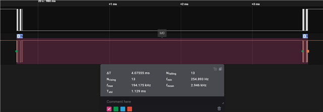

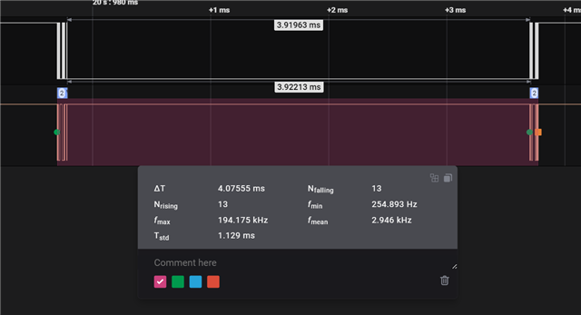

  • Dear Justin,
    We have tried to increase both master I2C bus speed to 400Khz and Remote proxy I2C setting to get to row 4 of this table
    And we can see much faster response in writing to the image sensor 0x10 ( from 6ms down to around 2ms to complete all 7 WRITE commands)
    However, we still see clock stretching on the combined WRRD(repeated START bit read write) in register reading to the serializer or other I2C client mounted on the back channel. And the delay varies from 200us to very long of 7-11ms, as you can see in the capture below.
    1. Combined RDWR to other client on back channel ( clock stretches to 11ms)
    2. Combined RDWR to the serializer ( 4ms)
    We are still struggling trying to understand what could be the cause of these long clock stretching. We are thinking of congestion along the FPD link, but what we can't explain is that there seem to be no problem in WRITE to the sensors, the time to complete 7-8 register WRITE is very consistent ( around 2ms with 400KHz bus speed, and around 7-8ms with 100Khz bus clock frequency), it doesn't vary much at all.
    We are thinking of some internal states of the 933 serializer might be the causes, but we don't know how to confirm this.
    Do you have any suggestions on what we should look at or any document about the serializer you could share with us?
    Kind regards,
    Tri
  • Hello Tri,
    The transmission of data in the Forward Channel and Back Channel is done in dedicated frames, where there are set slots available for I2C, GPIO, video data, etc... Congestion would not be an issue in our FPD-Link devices, since they are designed to to be low-latency bridge devices.
    In the screenshots that you are sharing, are those time values measured between the bytes in the same I2C Read command? Or are they the delay between the end of an I2C Read command and the start of the next one?
    Clock stretching typically refers to the time it takes for the Host to receive an ACK bit response from its Remote target. This occurs after every byte sent in an I2C command.
    But the images you posted seem to be a time measurement between different bytes and not between the byte and the ACK bit.
    Justin Phan

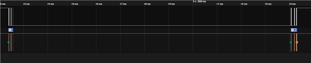

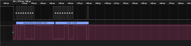

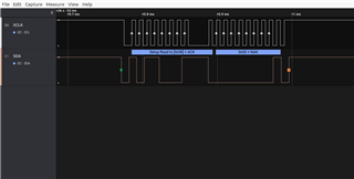

  • Hi Justin,
    Yes in my screenshots, those values are between the same I2C READ command ( between a WRITE and register READ back. Let me just zoom in 1 of those transaction
    1. The whole combined RDWR transaction
    2. The first WR
    3. And RD
    Is there anyway to find out why is the bus kept low for for that long
    Tri
  • Hi Tri,
    Just to double-check, are these I2C readings taken from the 934's I2C bus?
    My initial thoughts would be that the problem is on the ECU side.
    If you are probing the I2C bus on the 934 and are capturing the I2C signal during an I2C Read command, then the first 2 and last 2 bytes seem as expected, where there is a bit of delay between the I2C byte being sent to the remote serializer and the ACK bit that the serializer sends back.
      (The first WR)
    The only issue is that there is a large delay between when the 2nd byte and 3rd byte are sent in the total I2C Read command.
    After the ECU sends the second byte and receives its ACK bit, the ECU seems to wait for 7-11ms, before sending the third byte in the sequence. Note that when the ECU sends the second and third byte, the ECU is the Master that is controlling the SDA and SCL line on the 934 board. The 934 only controls the I2C line when it is recreating the ACK bit that was sent back from the 933. This is color-coded in the above figure.
    Do you notice the same behavior on the 934 I2C bus, when you have the ECU send a local I2C read command directly to the 934, or some other Slave device on the 934's local I2C bus?
    Justin Phan
  • Thank you very much Justin,
    Yes we have confirmed that the delay was caused by the ECU. The problem has been resolved.
    Tri
  • Thank you for the update. I'm glad to hear the issue is resolved. In that case, I will close this E2E thread.
