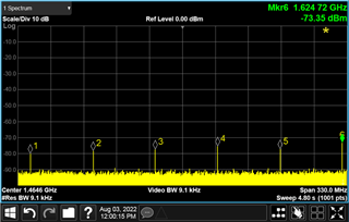

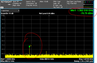

I want to konw the work frequency of SGMII.
When we use Signal Analyzer scan DP83TG720SWRHARQ1 on board, 1562MHz is very high.
So, I'm sure it's due to the SGMII signal.
Could you to provide a way to reduce the radiated energy. Such as: Spread spectrum or Change frequency or others.
Thanks!
Wang Yuxue
SGMII standard defines the signal to be 625MHz. How sure are you that this is due to SGMII? Can you try disabling SGMII on PHY and seeing if spur is still present?

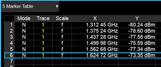

I am confirmed again, and have new find.
Signal Analyzer scan result as bellow, from the frequency point, about 62.5MHz is real cause.
When i power down DP83TG720S-Q1, the Peak point disappear immediately!
So, Please help comfirm DP83TG720S-Q1 work states, what cause of radiation.

Hello Wang,
Can you please provide the register settings for disabling SGMII? In addition, is CLKOUT active? If so, please disable it and see if it has effect on spurs.
Sincerely,
Gerome
Hi, Gerome
CLKOUT has been disabled, but the spurs also exist.
We try enable CLKOUT, more spurs appear, such as 1550MHz, 1600MHz.
Wang Yuxue
Thank you for the information. It is at this time we believe that the issue is caused by non-optimal layout regarding the SGMII traces. Please consult section 7.4.8.2 for more information on how to adjust layout.

Hi Wang,
Please follow the SGMII Signal Guidelines listed in DP83TG720.
For example, please ensure SGMII traces are length matched up to 5 mils. Also ensure that traces are no longer than 5". Also ensure that SGMII signals are differential impedance control as 100 +/- 5% ohms.
