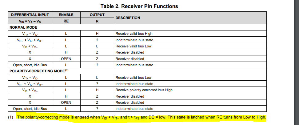

  • Hi Clemens, customer said when they test this 888 device whatever they put +200mV or  -200mV at AB, the R always output high level, is the non-polarity feature cause that? and how can we modify the test circuit
  • Yes; the bus-polarity correction feature assumes that an idle bus is high.
    To make the receiver switch low, you must input pulses shorter than tFS (44 ms).
  • Hi Stanley,
    Clemens is correct here as well.
    Please see highlighted line in datasheet excerpt below for polarity correction conditions:
    As a note - this device is only setup to work with fail-safe resistors - if these are not included device behavior may not be consistent with expected results.
