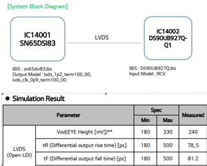

Hello team.
My customer is doing simulation with SN65DSI83 IBIS data + DS90UB927 IBIS data as below diagram.
LG uses 'lvds_1p2_term100_00' output modeling data and could measured Tr/Tf as below which it out of datasheet requires.
simulation result for Tr/Tf shows less than datasheet spec.
Here are question from customer.
1) Those simulation is no problem even they are out of datasheet spec??
2) Is their simulation condition correct??
Thank you.
