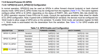

Can we use the SDOUT/ GPIO0 / PASS pin instead D_GPIO0/MOSI for giving the interrupt to Serializer through Backchannel.
can we configure the PASS pin as GPIO when we are not using BIST Mode and it is Disabled.
There should be no issue using SDOUT/ GPIO0 / PASS to pass through an interrupt signal. However, there is a difference in the timing constraints of both pins and D_GPIO is faster. Do you have any specific timing needs for the interrupt?
The configurations for each are in the datasheet and I have included the relevant table for GPIO0 (Table 7-2) below. In order to use GPIO0, BISTEN needs to be set to 0 to disable BIST mode.
Please let me know if you have any additional questions!
