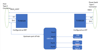

I am designing a USB hub board with USB charger option. It will be connected to host Type C usb connector as shown below.  I want Host to be charged through this USB connector and it should be able to act as upstream port to the USB hub.  I am planning to configure TUSB320 @ host side  as DRP  and  TUSB320@ power bank Type C connector side as UFP. Is this configuration OK?
