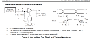

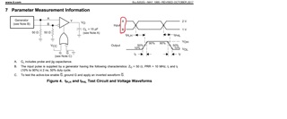

AM26LV32: AM26LV32CD datasheet section 7 confusion
  • Weilong,
    You are correct, if A is high and B is low, the bus output should be high. Thanks for pointing this out, can you use the "Submit Documentation Feedback" link in the bottom right of he datasheet page to create a ticket for this change?
