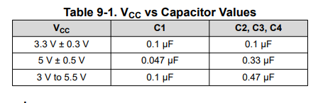

    It seems that all the capacitors being used are 0.1uF - which is only correct for 3.3V +/-10%.
    The capacitor table for the voltage ranges are shown below:
    These capacitors are going to be used by the charge pump so if that's incorrect the RS-232 outputs could be incorrect.

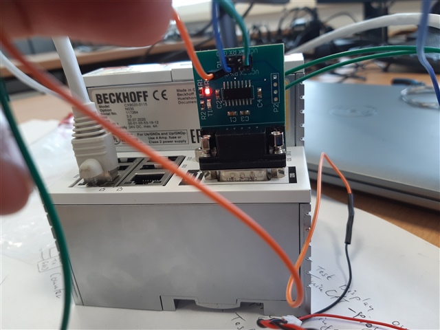

    1) The GND and TX pins CC are connected to the GND and RX pins of the

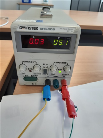

    "The GND and TX pins CC are connected to the GND and RX pins of the Converter as Shown in the first photo. Since there is no VCC wire coming from the CC itself, thee VCC pin of the Converter is supplied with a 5 VDC supply using an external Laboratory power supply as Shown in the second picture. So from what I understood is that the Converter needs to be supplied with a 3.3 V powersupply instead of a 5 V.
    Also I had a few question, If the RX LED is blinking Red signalling the reception of data, then shouldnt the TX LED also light up immediately even if the Converter is sending false data?
    Also if the Converter is not connected to the PLC and only connected on the CC side, Can we still sense the data at the DB-9 pin connector using the oscilloscope?"

  • That board does not connect the pins of the second channel. To prevent DIN2 from floating, connect the square pad to GND.
    All capacitors are 100 nF, so you should use a 3.3 V supply.
    The two images did not attach.

    From what I can answer - yes due the cap values (100nF each) the device is meant to have a 3.3V supply - if a 5V supply is still wanted the quickest change would be to remove C2/C3/C4 and change them each with a 0.47uF (470nF) capacitor. If 3.3V only is okay no modification is needed.
    Clemens is correct to identify that DIN2 if not used is floating which could cause DOUT2 to oscillate - so while I don't think this is the issue - this is best practice as I don't think the TTL  needs to RX and two TX wires. Only 1 RX/TX goes to the DB9 connector.
    Unless something is different in the picture that didn't seem to get attached - the Diode on the R pin will light up any time a logic 0 is received  and the Driver diode will light up when ever a logic 1 is received. Depending on data-rate and bit-pattern  during transmission these could be "solid" lights. But they aren't connected (i.e. if the driver is held high while data is being received then the diode shouldn't be lighting up.

  • Hi Marvin,
    Thanks for attaching the pictures - it makes sense to me now.
    The TX diode will only light up when the output is driven low - so it seems to be high at this point.
