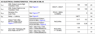

  • Hello Don,
    PATGEN is a feature that is built-in to the 927 device. You can enable it to generate a test pattern image, which will be sent to the display instead of your camera input. See the below App Note for more details on what registers to set to configure PATGEN:
    https://www.ti.com/lit/an/snla132g/snla132g.pdf
    If you are getting the expected test image appearing on the screen, then the link between the UB927 ->UB928 -> Frame Grabber(DS90CR288) ->Display has a low chance of having an issue. But since you said that you are able to get your application working in "Full Mode Application", then I doubt that the connection between the UB927 and UB928 is an issue.
    The next thing that you can try is to measure the RxCLKIN+/- pins on the 927 device, to see if it meets our required datasheet specifications.
    If your system does meet these jitter requirements, then it is likely that there is no issue between the DS90CR287  -> UB927.
    Next, you should probe the inputs to the DS90CR287 device and confirm that all of the inputs meet the required switching characteristics.
    As long as the input into the DS90CR287 and UB927 devices meets the datasheet requirements, then our system should support your 10-tap/8-bit configuration.

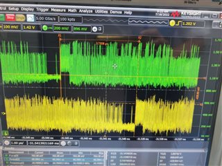

    We are unable to measure UB927's output jitter. But the signal from UB927's input to UB928's output seems OK. the measure is as follows.
    The green is input and the yellow is output.

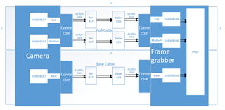

    Is the difference between the Base/Medium/Full setups the fact that 1 camera is used in the Base setup, which is connected to a single 927/928 pair, and that the Full setup uses 3 cameras, where each camera is connected to a separate 927/928 pair?
    Not 3 cameras. Only one camera that contains 2 connectors for cable link is used in this system.
    there are 2 cables connecting camera and frame grabber. For base cable, there is 1 pair of 927/928. For full cable, there are 2 pairs of 927/928. the application diagram of the system is as follows:
    If the camera is configured for 10-taps/8-bit mode, is the hardware the same? If so, how would the 28-bit parallel data output be mapped to the inputs of the 927 serializers?

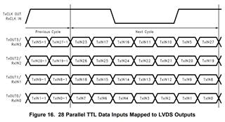

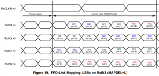

  • Hello Don,
    I will need to look into the documentation a little more and provide comments within ~1-2 business days.
    Justin Phan
  • Hello Don,

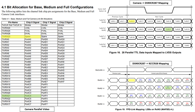

    Is there someone from the camera manufacturer that you can reach out to, in order to confirm the parallel video pin mapping of the camera when it it configured for Full Mode vs. 10-Tap/8-bit Mode?
    My understanding is that Section 4.1 and 4.2 in the document you shared with me do describe the bit mapping. A port is defined as an 8-bit word, so a port should represent 8 parallel data lanes from the Camera to the DS90CR287 device. Ports A, B, and C should represent 24-bit RGB parallel data lines into the DS90CR287 labelled Chip X. There are also 4 signals leading into the DS90CR287, which should stand for HSync, VSync, DE, and Spare.
    The Full Mode configuration seems to work because the mapping aligns with how our 927/928 devices map the RGB bits in the LVDS stream. See example below:
    In the Full Mode setup, if you look at the green highlight in the figure, it seems that Parallel Video pin TX/RX21 outputs data labelled "PortC4", which must either be an RGB value of some sync bit. The DS90CR287 will map the parallel video in the LVDS format in the upper-right image, where PortC4 is mapped to the TxIN21 slot. The 927/928 will treat that TxIN21 slot as one of the blue bits in the RGB data being sent from the camera (B[6]).
    If the TX/RX21 pin on the camera is outputting bit 6 of the 8-bit Blue video data, then all of the mapping matches and you will get your expected video display. If the mapping does not match, then one likely symptom is that your display will show a discolored image, since you are not mapping the RGB data correctly.
    These are all assumptions on my part, since I am not familiar with the camera module being used. The 10-tap/8-bit setting seems to send different RGB data bits to different parallel video pins on the camera.
    If you have a question on the TI part, I can help answer, but this seems like a question you need to ask the camera manufacturer and you should confirm what video is being outputted at each pin of the camera in the different modes.
    Justin Phan
