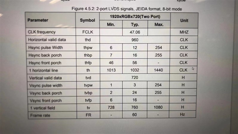

Our customer would like to change UB949 EDID in EEPROM, can you suggest how to config the code with below timing?
Thanks.

Hey Johnny,
please check the following e2e thread for this topic:
https://e2e.ti.com/support/interface-group/interface/f/interface-forum/1110351/ds90ub949a-q1evm-how-to-write-edid-into-ds90ub949
