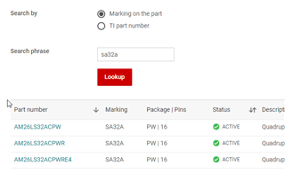

Can you please help me to find out what the significance of the 'B' in this PN is? My belief is that the device is in a 16-pin SOP package (DB) versus the 16-SOIC package (D). If you could help to confirm this suspicion, that would be great.

    Please see the attached phots of the stock we have on hand. I also have this from ti.com and their part marking lookup function:

  • Hi David,
    So the SA32A is part of the marking - which is correct.
    I found DB devices in our lot code system.
    Can you confirm the 2nd and 3rd lines of the parts are labeled:
    2nd line: \TI Symbol/ D5K
    3rd line: AV57
    If this is correct - you may have counterfeit devices and please go here: https://www.ti.com/support-quality/quality-policies-procedures/anti-counterfeit.html for next steps. As I was able to pull data for this part over the last ~10 years and I didn't find this marking.

  • Hi Parker,
    After reviewing the pictures, I am seeing the 2nd line of text is "05K". Does this match what you are able to see?
    Thank you
  • Hi David,
    Thanks for the clarification - I am still not pulling up any information on this. I suspect these might be counterfeit - please see the link I posted in my last reply as that should guide next steps - there could be something I am missing (this part is pretty old - so I may not have all the lot information) but the link should help guide next possible steps.
