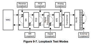

we are currenty struggeling to get the DP83826I PHYs running with Sitara AM243x.
To analyze the problem step-by-step we tried to get the "enet_layer2_icssg"-example from the AM243x SDK (V08.03.00.18) running on our own hardware target, where we use the DP83826I PHYs.

Next we run the example on our hardware target and the logs from the application look fine, but we are not able to see any communication via the PHYs:
      MULTIPORT TEST
Init all peripheral clocks
Enabling clocks!
Open all peripherals
Init  configs EnetType:2, InstId :1
icssg1: Open port 1
EnetPhy_bindDriver:1718
icssg1: Open port 2
PHY 3 is alive
PHY 7 is alive
icssg1: Register async IOCTL callback
icssg1: Register TX timestamp callback
Attach core id 1 on all peripherals
icssg1: Attach core
Create RX tasks
icssg1: Create RX task
icssg1: Waiting for link up...
Enet Multiport Menu:
 'T'  -  Enable timestamp prints
 't'  -  Disable timestamp prints
 's'  -  Print statistics
 'r'  -  Reset statistics
 'm'  -  Show allocated MAC addresses
 'd'  -  Enable dscp based priority mapping
 'x'  -  Stop the test
Icssg_handleLinkUp:3060
icssg1: Port 1 link is up
icssg1: Set port state to 'Forward'
icssg1: Async IOCTL completed
icssg1: Port 2 link is up
icssg1: Open DMA
initQs() txFreePktInfoQ initialized with 8 pkts
icssg1: Set MAC addr: 70:ff:76:1d:92:c1
icssg1: MAC port addr: 70:ff:76:1d:92:c1
We can't see any communication from the target (it should loop back all received frames) but the Link detection etc seems to work. As we looked a bit deeper in the example we set a breakpoint in the EnetUdma_rxCqIsr() function and it is never called.
The check the correct PHY configuration we made a PHY Register Dump right after Startup:
PHY 3 Register Dump
Register 0000 is: 2100
Register 0001 is: 7849
Register 0002 is: 2000
Register 0003 is: A131
Register 0004 is: 0181
Register 0005 is: 0000
Register 0006 is: 0004
Register 0007 is: 2001
Register 0008 is: 0000
Register 0009 is: 0020
Register 000A is: 0100
Register 000B is: 040B
Register 000C is: 0000
Register 000D is: 0000
Register 000E is: 0000
Register 000F is: 0000
Register 0010 is: 0004
Register 0011 is: 0108
Register 0012 is: 0000
Register 0013 is: 0000
Register 0014 is: 0000
Register 0015 is: 0000
Register 0016 is: 0100
Register 0017 is: 0041
Register 0018 is: 0400
Register 0019 is: C003
Register 001A is: 0000
Register 001B is: 007D
Register 001C is: 05EE
Register 001D is: 0000
Register 001E is: 0102
Register 0467 is: 00CF
Register 0468 is: 2586
