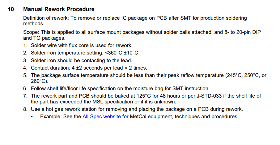

Can THVD1420 be reworked after reflow soldering? Also, if it is an IC that can be reworked, could you tell me the conditions (soldering temperature, time)?
Astro
Hi Astro,
Yes - you should be able to rework either package after reflow.
Please see more detailed instructions on rework procedures in section 10 (shown below) of document located here: https://www.ti.com/lit/an/spraby1a/spraby1a.pdf?ts=1659982078853&ref_url=https%253A%252F%252Fwww.google.com%252F
For general Reflow information see here: https://www.ti.com/lit/an/spraby1a/spraby1a.pdf?ts=1659982078853&ref_url=https%253A%252F%252Fwww.google.com%252F
These two documents should give you all the information you are looking for - if you have any other questions please let me know!
