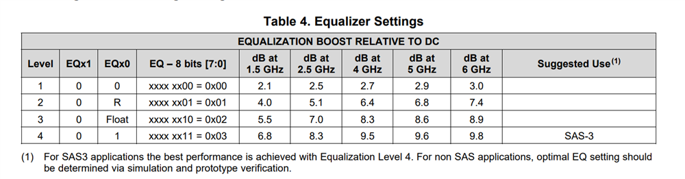

Hi Jeff,
I would recommend having 3 dB of insertion loss prior to the DS125BR111 receiver in order to ensure that the signal is not over equalized.
Drew
