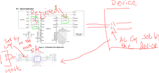

1. How many PCB Trace cables and several meters of Cable can this chip meet at the same time? We need 500mm PCB Trace+ 7M U3 cable.I wonder if this chip can meet our requirement, or if there is a better chip, we can recommend it;

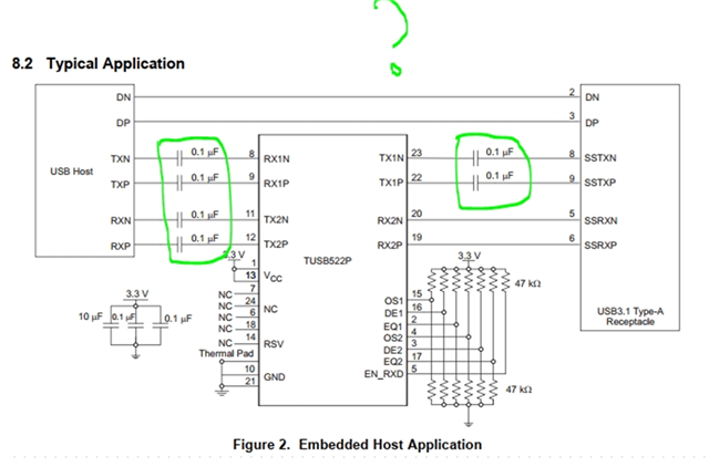

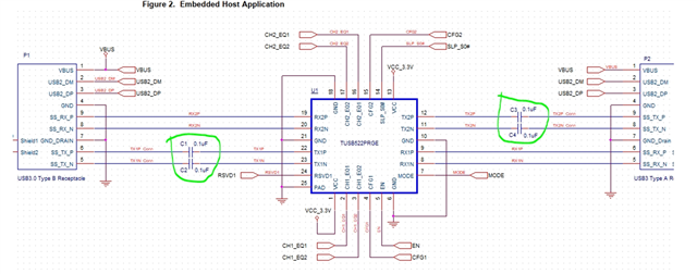

2. Does the chip differential signal need only Tx with AC coupling capacitor or both Tx\Rx? Close to which side?
3.The left figure is the recommended application in the data manual, and the right figure is the schematic diagram of the Demo board
