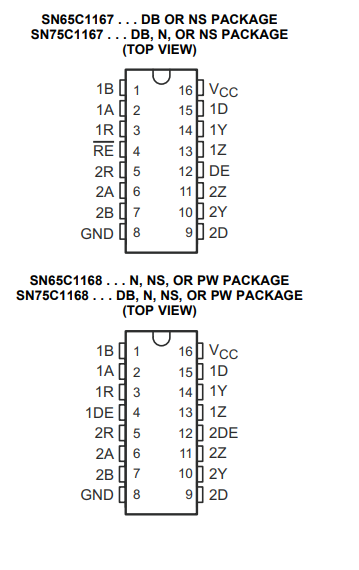

Hi Experts,
We understood that:
1. if one output is shorted for more than one second or
2. if both outputs are shorted.
the component will be damaged.
Our customer wonder the scenario where such conditioned short circuit (like only one output shorted, or shorted for less than a sec) might occur. He said that he might have misunderstood the statement in the datasheet.
They also needed some option for output short protection. Atleast longer than 1sec. We hope that you can help us.
Thank you and kind regards,
Gerald
  • Hi Gerald,
    So all the parts that match this part (full duplex / 2 drivers / 2 receivers ) all have the note of no more than 1 second of a short circuit.
    So if the same architecture is to be used with TI components a short circuit detection mechanism that resolves the short in < 1 second would be needed. Do you know why the customer cannot respond to a short circuit in under 1 second for the system?
    That being said - we don't have this note/warning on newer devices, nor typically do we spec an abs max current (we still spec a min/max short circuit current - but its a different spec.) It generally is more based on a case by case basis. The junction temperature is the most concerning parameter during short circuit events as the current can be large enough to heat the junction up pretty quickly - so there is generally a time but it isn't spec'd as it varies a lot based on system parameters. However there aren't options in the current full duplex 2TX 2RX device that is being used that allow for the flexibility that may be needed by the system. As one last note - we don't guarantee a time on most of our other parts - it is more flexible because the concern is junction temperature so it could be estimated.
    Please let me know if the customer is open to a multi-chip solution as I don't think we have a single chip solution that can work in this application.

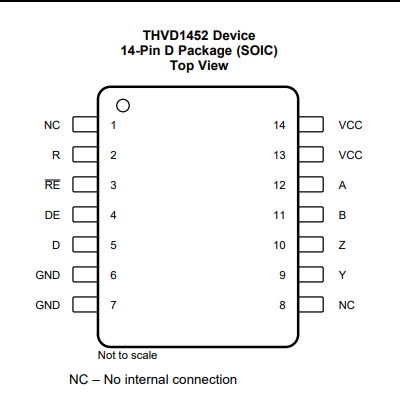

    THVD1452 in the SOIC package - its a full-duplex device, but only 1 channel. Its R_theta_JA is 86.4 C/W and the THVD14xx family at a 5V supply during short circuit can burn around 1.3W at the driver (based on the VOH/VOL graphs to get output impedance of the driver) so this will add ~112 degrees from the ambient temperature. This can be reduced by using layout techniques and possible adding heat sinks to keep the junction temperature under 150C - as going above is where there could be problems. The max differential rise time is 6ns

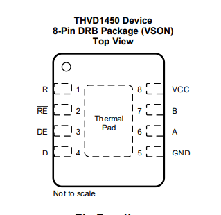

    The THVD1450 is another option (in the DRB package) - this device is only half-duplex but has the benefit of a low R_theta_JA of 48.6 C/W with the same output impedance as the THVD1452 so under a short you add ~63 degrees from the ambient temperature - so its possible that extra heat sinking may not be needed.

    Its the same names on the pins so you just need to match the pin names when looking at the new parts - please see current part SN65C1167 - where you could get 2 TX and 2 RX in full duplex:
    THVD1452 (SOIC) This is a 2 chip solution - full-duplex; however it could gain ~112 C from the ambient without heat sinking - its pinout is shown below:
    The pins mean the same thing on both devices - so Z goes to Z, Y goes to Y ... etc..
    This solution would require heat sinking though in a lot of applications
    The next solution is the THVD1451 (in VSON package)  which is one of the best in terms of heating. It is also a 2-chip solution - however the one difference is there are no enable pins - the driver and receiver are always on
    If the always on feature is not going to work we have another device with the same heating parameters to the 1451. It is the THVD1450 in the VSON package it's a 4-chip solution since it half duplex - that means the A/B pins also function as the Y/Z pins on a full-duplex device. You can create a full duplex system by using 2 transceivers per node - one for RX and one for TX:
    The THVD1450 and THVD1451 in the VSON package would be the best as they have thermal pads which help dissipate a lot of heat. The THVD1452 is possible but there would probably need to be heat sinking added to the application.
