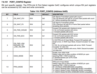

  • Do we have initialization table of 954 and 953 or some reference guide?
  • For 954 mode pin, customer configurate it into CSI-1 mode in hardware. They want to know can they change it to RAW-10 mode by software configuration after power up?
