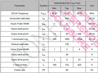

Our video structure is DS90UH941AS-Q1 pair with DS90UB926Q-Q1. Our panel spec would be 1920*720. (Two Port)
According to panel spec, the DCLK frequency is under 85Mhz. Can bandwidth of UB926 support 1920*270 panel?
Please help to confirm. Thank you.
    What is shown in the above panel spec is the DCLK frequency for one of the two OLDI port interfaces to the panel, so it is only half of the equivalent total horizontal panel timing. Also this panel spec appears to be for an OLDI type panel, not parallel RGB. So the total DCLK rate is 45.21*2 = 90.42MHz and you would need to use DS90UB948-Q1 instead of DS90UB926-Q1 to get dual OLDI interface.

    The next stage of DS90UB926-Q1 is Video processor. It can output dual LVDS to our Panel.
    As you said, the DCLK rate of this 1920*720 panel is 90.42MHz, so the bandwidth of DS90UB926-Q1 is not enough. Is my understanding is correct? Could you recommend higher bandwidth of Deserializer? (FPD-link to RGB888 and bandwidth is higher than 85MHz) Thank you.
    DS90UB926-Q1 is not enough bandwidth for this pixel clock/DCLK rate.
    As Casey mentioned, DS90UB948-Q1 can support this video bandwidth, however it has a output interface of OLDI instead of RGB. So the panel input will need to support OLDI instead of RGB.

    Can DS90UB948-Q1 support video bandwidth up to 99MHz for single channel? CPU standard output video bandwidth is 99MHz for 1920*720 resolution. (2200*750*60Hz) Thank you.
    For 99MHz, two channels will be required (dual lane FPD and dual OLDI).
