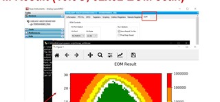

Hi Ti experts,
There have the 948 eye map related software data?
Part Number: DS90UB948-Q1
Other Parts Discussed in Thread: ALP
Hi Ti experts,
Hi Ian,
For eye diagram analysis, we recommend using the Margin Analysis Program (MAP) through Analog Launch Pad because customer's controls and configuration have different circumstances. MAP provides access to the recovered signal after echo-canceller, AEQ, and CDR. Here are a list of documents that can be used to understand how to use the MAP tool with the 948 device:
