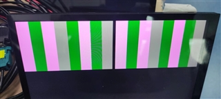

DS90UB954-Q1: The change of Mipi channel leads to incomplete image
Part Number: DS90UB954-Q1
Other Parts Discussed in Thread: ALP
Imx8qm  mipi csi < ------> ds90ub954 <------> ds90ub953
                                                            <------->ds90ub953
 when the configuration of ds90ub953 is in pattern mode and the configuration of the physical data channel of ds90ub954 is 4, the acquired image has black edges.
 When the physical data channel of ds90ub954 is 2, the display is normal
1.Register setting when Mipi physical data channel is 4
 {0x33, 0x43},   /* 4 lane */
 {0x1F, 0x00},   /* 1.6Gps csi clock per lane */
2. Register setting when Mipi physical data channel is 2
 {0x33, 0x63},   /* 2 lane */

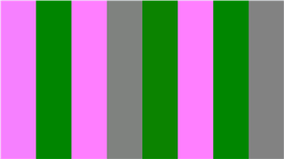

  • Supplementary note:
    The format and size of the image generated by the pattern mode are consistent with the output of the camera. Therefore, the pattern mode is used for debugging.  In fact, the camera also encounters the problem of black edges。
    The connection mode between the camera and ds90ub953 is 4 data lanes

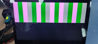

    Show black edges:

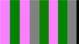

       3.2  ds90ub954 data lanes is 4, The display is normal without black edges
       {0x33, 0x43}, /* 0x43 csi continuous clock mode, 4 lane enabled TX0, csi output enabled */
       {0x1F, 0x00}, /* 0x02(800Mbps) 0x00 1.6Gps csi clock per lane */
      3.3 ds90ub954 data lanes is 3, The display is normal without black edges
      {0x33, 0x53}, /* 0x43 csi continuous clock mode, 4 lane enabled TX0, csi output enabled */
    4. From the test results, the rgb888 display is normal. Why is the YUV display abnormal?
    5. For the video of YUV422 1920x1080x60x1.25, if the two ds90ub953 inputs use 4 data lanes, can the ds90ub954 output use 3 data lanes ?
        The actual test video has the phenomenon of jamming, but there is no black edge

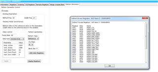

    Could you provide a screenshot of the information tab in ALP? It is possible that the YUV error may be due to ALP and not the 953. Could you try to enable pat gen manually with the registers or scripting tab? The attached script below will enable pat gen for your parameters. You can also set the necessary registers by toggling the appropriate bits in the registers tab.
    #Patgen YUV 1920x1080p60  8 Colorbar
    devAddr = 0x30  #update as necessary
    Board.WriteI2C(devAddr,0xB0,0x00) # Indirect Pattern Gen Registers
    Board.WriteI2C(devAddr,0xB1,0x01) # PGEN_CTL - enable patgen
    Board.WriteI2C(devAddr,0xB2,0x01)
    Board.WriteI2C(devAddr,0xB1,0x02) # PGEN_CFG - blocksize 2
    Board.WriteI2C(devAddr,0xB2,0x32)

    According to the above configuration, there are still black edges。What are the possible reasons for black edge?
    For Mipi signals using 4data lanes, why is the RGB format video normal, while the YUV format video has black edges

  • The black edges are likely caused by a timing or blanking issue/mismatch. Can you confirm the active and blanking parameters of your display and provide a register dump and screenshot of the information tab after pat gen has been enabled?
    Darrah

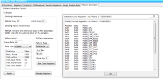

  • Under the condition that the configuration of the  two-way 953 is unchanged, the display can be normal by using ds90ub960, and the acquisition and display problems of the imx8qm are eliminated. Also consult the FAE of NXP, and it is recommended to adjust the sampling timing of 954.
    Since the hardware design does not support ALP configuration, ALP is used to view the registers configuration.
    The following figure shows the configuration of registers of 954 and 953:
  • Okay, I did not realize that you were not enabling pat gen through ALP directly. Thank you for the register dumps, I will look over them to see if anything could be causing an issue and needs to be updated.
  • Looking at the register values it looks like the 954 is reporting an unstable line length/count and CSI errors (register 0x4E). There are also length and data checksum errors (register 0x7A). These errors could indicate an issue with the connection. Additionally, could you try setting register 0x41 = 0xA9 on the 954?
