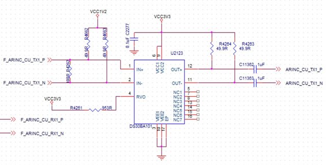

We are planing to do AC coupled for the input.
So I want to know do we need any pull on input side of this IC for common mode input voltage. The input is coming from FPGA side.
Below is the ref design.
