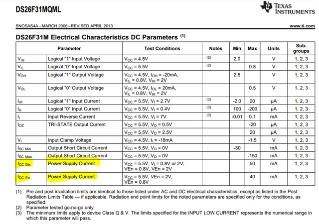

We have seen high current consumption(approximately 30 mA) while Enable'(active low) pin is held High and Enable(active high) pin is held as high. But when Enable' is held low (While Enable pin is still held as High),  the current consumption reduces to 19 mA. Could you please explain why current consumption is getting higher in that case?

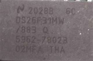

    Can you take a picture of the topside of the IC? Both of these currents seem high for ICC, so I want to make sure we're looking at the right device. Also, what else is happening with the device during the current measurement?

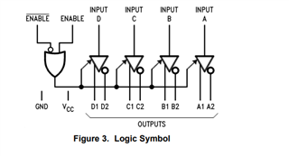

    Also for truth table - there isn't an explicit one - however it can found in the datasheet from the functional block diagram or logic symbol:
    /ENABLE and ENABLE are OR'd together - so the truth table would look like this:
    ENABLE /ENABLE OUTPUT_STATE
    1 x Enabled
    x 0 Enabled
    0 1 Disabled (Hi-Z)

  • Hi Parker,
    Please see below picture for the part number. BTW, if we put the device in disabled case, is it possible to mitigate SEU effect such as stuck @1 or stuck @0 on output pins?
    Zafer Çalışkan
  • Thank You Zafer,
    The part number and markings look okay - so that's good.
    The disabled current is higher than the enable current on the device:
    This is due to the logic circuits shunting more current in the disable state compared to enabled state. It isn't super common in devices - but for this device that's how the datasheet states it will work. Minimizing current is to place 0V or VCC only on these enable pins (the closer to threshold the more current is shunted for ICC) as this test is using threshold values which will cause larger currents.
