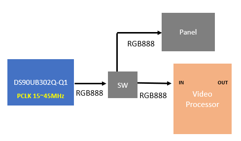

Dear TI Engineers,
I can't find DS90UB302Q-Q1, so I chose DS90UB926Q-Q1 to ask a question.
Can DS90UB302Q-Q1 output RGB888 to Panel and Video processor at the same time via switch IC.
Do you have this kind of switch IC?
Thank you.

Hi Tzu,
The FPD-Link portfolio does not cover switches/muxes for RGB888. For FPD-Link devices that output in RGB888, only one port can be dedicated due to pin count. I recommend visiting TI's portfolio of switches and multiplexers that can handle LVCMOS and asking in that area.
The DS90UB302Q-Q1 is very similar to the DS90UB926Q-Q1 but not as supported.
