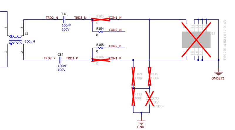

Hi team,
For MDI component ratings -
  1. There are some differences between TI documents (datasheet, app note) in terms of DC blocking cap tolerance and ESD shunt resistor tolerance. Could you please comment which tolerance customer should follow?
  2. There is no BOM info in EVM guide and it will be good to share the EVM BOM for complete info such as tolerance, voltage rating and power rating.
  3. There are differences between TI and OPEN Alliance recommendation - TI's rating is higher resulting in larger and more expensive components. Could you please comment?
  4. Ultimately, could you please recommend tolerance, voltage/power ratings for all the MDI components for customer to pass OPEN Alliance compliance test?
  Value TI EVM R & C TI EVM Rating TI Datasheet Rating (Table 9-1) TI App Note SNLA389A (Table 2-1) TI Recommendation OPEN Alliance
DC Blocking Cap 0.1uF C40 & C84 100V 10% 100V 1% ?V ?% 50V 10%
MDI Coupling Cap 4.7nF C93 1kV 10% - ?V ?% 50V 10%
Common-Mode Termination Res 1kohm R109 & R110 - 1% 0.75W 1% ?W ?% 0.4W 1%
ESD Shunt Res 100kohm R113 - 10% 0.125W 5% ?W ?% 0.1W 10%
