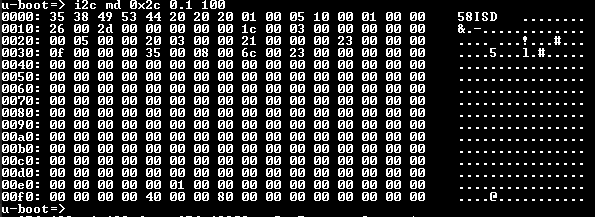

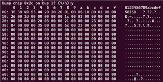

I am using SN65DSI83 MIPI to LVDS convertor connected to iMX8M Mini SoC in MIPI end and 10.1 inch Display in LVDS end.

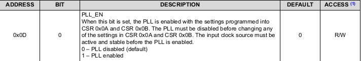

It is functional in kernel 5.10 and I am developing Uboot driver for the same I took I2C dump form kernel and did the same register configuration in Uboot. There is a contradiction in PLL_EN and PLL_EN_STAT i.e., 0x0D and 0x0A register. PLL_EN value is 1 where as PLL_EN_STAT is 0
PFB Image:
Kernel I2C dump:
Uboot I2C dump:
PLL_EN_STAT register description.
PLL_EN register description:
0x0D bit is 1 i.e., PLL is enabled but we can see from the PLL_EN_STAT it is not enabled.
I enabled the test pattern by writing 0x10 in 0x3c register. And I could see one vertical line at left side of display.
Could you please help us here to understand the issue while getting Test pattern in display.

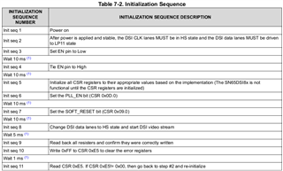

  • Hi Zach,
    Display is working fine with the I2C register configuration in kernel but the same I2C configuration is not working in Uboot.
    I followed the same power sequence provided in datasheet. PFB image.
    Their is only one I2C register configuration is different 0x0A in kernel its value is 0x85 and in uboot it is 0x05
    0x85 hex = 10000101 and 0x05 = 00000101 we can see from 0x0A register table 7th bit is read only bit.
    It is PLL_EN status bit which is enable as we can see 0x0D register is 0x01.
    Could you please tell us the reason of this contradiction.
    Kaushal Verma

  • Zach,
    Understood, I found the difference in Kernel and Uboot. When I enable 0x0D register It automatically update 0x0A register in Kernel. But It didn't change in Uboot.
    Could you please look into this.
    Kaushal Verma

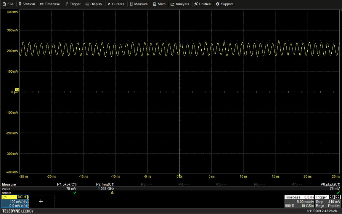

  • Kaushal
    Are you using the MIPI DSI or the Ref clock as your clock source? Can you please probe the clock and the DSI83 EN pin to make sure the clock is up and running before the EN goes from low to high?
    David
  • Hi David,
    We are using MIPI DSI clock to drive SN65DSI83.
    I measured the DSI clock before kernel starts i.e., in Uboot and it is 1.049GHz. But in Kernel it is 228MHz.
    PFB waveform:
    Although I have added the clock frequency of 228MHz in display timing parameter and SN65DSI83 driver as well.
    Could you please suggest, what may the cause of this huge difference in MIPI DSI clock frequency.
    Kaushal Verma

  • Hi Zach,
    Could you please tell me the procedure to put SN65DSI83 MIPI to LVDS convertor in LP11 state.
    Please tell me the procedure to verify weather it is in LP11 mode or Normal mode.
    Kaushal Verma
  • Hello Kaushal,
    When the MIPI inputs are driven to LP11 this means that both P and N pairs of all MIPI DSI differential pairs are driven to single ended high ~1.2V.
    This can be verified with an oscilloscope by probing the P and N pairs of the MIPI DSI.
    Zach

  • Hi Zach,
    Thanks for the support.
    We are getting 1049 MHz in MIPI DSI and I used clock divider 14 to make it around 76 MHz in LVDS and could see the proper test pattern in LVDS in Uboot with developed driver.
    When I disabled the test pattern I could see the fluctuating splash screen.
    As per my observation the issue is 0x12 register of SN65DSI83.
    CHA_DSI_CLK_RANGE
    This field specifies the DSI clock frequency range in 5-MHz increments for
    the DSI channel A clock
    0x00 through 0x07 – Reserved
    0x08 – 40 ≤ frequency < 45 MHz
    0x09 – 45 ≤ frequency < 50 MHz
    0x63 – 495 ≤ frequency < 500 MHz
    0x64 – 500 MHz
    0x65 through 0xFF – Reserved
    We can use the DSI clock upto 500 MHz only and in our case it is 1049 MHz.
    Could you please provide your inputs here and help me to debug this issue.

  • Hi Zach
    I checked with NXP and I am not getting any support on how to change Uboot MIPI DSI clock. It is 1049 MHz by default so I am setting 0x0b register DSI_CLK_DIVIDER 14 to get clock around 76 MHz but the splash screen is fluctuating because I cannot set CHA_DSI_CLK_RANGE more then 500 MHz.
    Could you please help me set MIPI DSI clock below 500 MHz in uboot or if you have any workaround to set CHA_DSI_CLK_RANGE for 1049 MHz.
    Thanks for your help.
    Kaushal Verma
  • Kaushal,
    DSI clock rate within spec needs to be below 500 MHz. If the MIPI source provides higher than that using Uboot then it cannot be supported by the DSI device.
    However, you could try using a REFCLK instead of the DSI CLK.
    Zach
