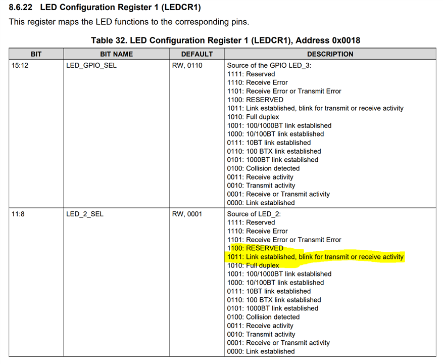

The phy is configured for rx+tx (default) => with medium to high traffic the led is almost all the time on. It is much 'slower' compared to other activity LEDs.
The blinking register doesn't seem to do anything.

  • Hi Christian,
    Can you please let me know if you are referring to LED_2?
    Can we rule out the blink rate dependency on the traffic? Can you please increase the activity to the highest possible and confirm if the blink rate is the same?
    Gokul.

  • Hi Christian,
    Sorry for driving you in a wrong direction.
    LED_2 on DP83867 by default doesn't blink when there is activity. LED_2 is on when there is activity and off when there's no activity.
    If blinking is required please program the LED_2 to the highlighted configuration.
    Gokul.

    We try to use the highlighted configuration, maybe this is what we need, but I think this is for a combined Link/Activity LED
  • Hi Christian,
    If the highlighted config is used, LED_2 will be on always when there is link and no activity. It will blink when there is activity.
    Gokul.
  • Hi Gokul,
    We tried the 1011 configuration, but as expected it is not what we want.
    I guess we have to live with the current behavior.
