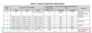

Now the problem is, the same camera can work with one of my project, PROJECT A, through BC_FREQ_SELECT configuration of 110: 50 Mbps (default for DS90UB953-Q1 or DS90UB935-Q1 CSI
Synchronous back channel compatibility).
Another project, PROJECT B, can only work through BC_FREQ_SELECT configuration of 010: 10 Mbps (select for non-synchronous back channel
compatibility). If I use the same 50M configuration, the link can not establish a stable lock status, and the LOCK_STS_CHG is always asserted.
The default 954 MODE pin configuration of both my projects is,
I don't know if the camera is working under synchronous mode or non-synchronous mode, but it seems confusion from the behavior of the 2projects.

    1. I just configure 954's BC_FREQ_SELECT to 010: 10 Mbps (select for non-synchronous back channel compatibility).
    I'm not sure if this will change the 954 to non-synchronous or just reducing the back channel rate.

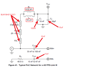

    2. The Poc Network on my board is copied from the TI spec and have some value changed. I've marked the changes below,

    1. Yes, changing the BC rate on the 954 is the correct way to set it to Non-Synchronous Mode.
    2. Okay, it seems that you are using the recommended 4G PoC network listed in the datasheet, which is rated to support Sync and Non-Sync operation between the 953 and 954.

    1. I'm wondering if changing the BC rate just means to changing the frequency, or also means changing between non-synchronous mode and synchronous mode?

    1. When you want to pair a SER/DES in Synchronous MODE, you need to configure each device to have a matching setting. The deserializer needs to be set to output a specific Back Channel rate. The serializer will need to be set to use a specific signal as its reference clock, in order to drive the Forward Channel output. The deserializer only needs to be set to the correct Back Channel rate that is compatible with the serializer's current MODE.
    2. One thing to note is that the datasheet PoC network is only rated up to 150mA. Do you know if the camera PCB in PROJECT B is drawing more than 150mA?

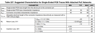

    3. Since it seems there is some hand-soldering going on, there might be an impedance mismatch introduced by excess solder. We require a tightly-controlled 50-Ohms (+/-10%) single-ended impedance along the entire high-speed FPD-Link channel. Going outside this range will cause reflections that will distort the high-speed data and cause unstable LOCK.

      1. A deeper next step would be to confirm that the high-speed PCB traces meet the S-Parameters and Impedance requirements stated in the datasheet, through lab equipment measurements using a VNA.

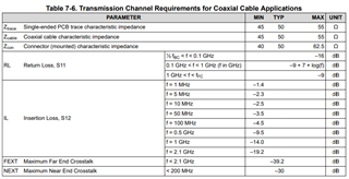

      2. The 960 datasheet also includes the required channel specs for the entire channel, from DOUT+ on one PCB to RIN+ on the other:

    The issue just got solved by using a standard coax cable without soldering.
