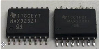

Part Number: MAX3232
Hello
Can you please let us know the difference between the two ICs numbers
Attached in image
11CGEYT MAX3232IG4
1CC1F2T MAX3232IG4
Hello
Attached in image
11CGEYT MAX3232IG4
1CC1F2T MAX3232IG4
Atharv,
The seven digit code before the MAX3232IG4 part number is the lot trace code. The first 2 digits are year and month that the device was assembled, the next 4 digits are the lot trace code, and the last digit is the assembly site. The difference in these two particular part numbers is just showing that these devices came from different lots.
Please let us know if you have any other questions.
Eric Hackett
