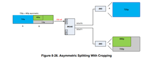

I use 941AS Asymmetric Splitting mode to light two LCDs  simultaneously. but there is come confusion about it, does Asymmetric Splitting mode have timing requirement for the two LCDs?
LCD1 current spec LCD2 LCD1 supplyer can modify

can you  comfirm that "LCD1 modifyed" porch timing  can work with LCD2, 941 in Asymmetric Splitting mode
  • If the posted "LCD1 porch timing" can not work with LCD2, please give us a porch timing for us to take request to supplier

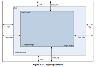

    I have taken a look at the information you have provided. In regards to timing, the superframe must include two identical size images. To do this, the 941 crops the smaller image and puts the extra pixels into the blanking of the smaller displays.
    Can you please list out the minimum and maximum of each hsync, hbp, hfp, vsync, vbp, vfp for each display?

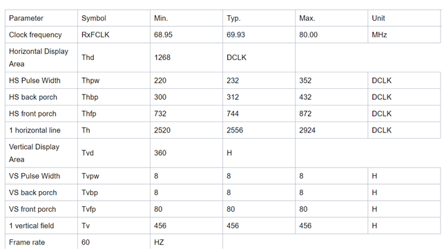

  • the current hsync value can not match it, we have to ask supplyer to ajust a porch value  for us. so I should suggest a porch value for the supplier.
    the image include current timing porch max,min value.
    if adjust LCD1 to this one can it work with LCD2?

  • I have taken a look at the information you have provided. In regards to timing, the superframe must include two identical size images. To do this, the 941 crops the smaller image and puts the extra pixels into the blanking of the smaller displays.
    so the smaller display need a bigger hbp,hfp, vbp, vfp value than the bigger display for croping ?
    how about the hsync and vsync , if the two display should have save vsync value?
  • Hi!
    1. Yes, the smaller display needs a greater blanking state (hbp, hfp, vbp, vfp, vsync width, and hsync width) to support the extra pixels. Please see this diagram from the datasheet.
    2. There are no timing requirements that require the same vsync width or hsync width values for our devices. The frame rate must be the same for the superframe and all output images.
    3. Your Hactive and Vactive for the LCD2 display are now 1268 and 360.
      Using the timing table that you have just provided for LCD1:
      Horizontal Maximum total + blanking: 1268+352+432+872 = 2924. This 2924 > 1268.
      Vertical Maximum total + blanking: 360+8+8+80 = 456. This 456 > 360.
      We would be able to support the display that you have now provided.

    In the 941AS after splitting, note that each video of each display would be half the frequency of the superframe. In addition, any horizontal blanking on the superframe image is divided by two for each individual image. Vertical blanking (VFP, VSYNC, VBP) are all the same number of lines between the two split images.
    If you needed to, you can adjust the horizontal blanking to be divided into HFP, HSYNC, HBP. Those are the IMG_HSYNC_CTL registers. While the total number of pixels stay the same, you can use those registers to help you split into HFP, HSYNC, HBP to the way that you need it.

    1. Yes, that is correct. Cropping will allow you to adjust the size of your active resolution. Excess blanking from cropping is added to the horizontal and vertical porch for the final image. Yes, vsync width will remain the same as the superframe image. Hsync width can be adjusted.
    2. Yes! Thank you for correcting my typo. In the working state, when the two images are split, the two images will have the same htotal and vtotal. So when you have a 2880 x 1080 superframe, you will have two equal images of 1440 x 1080. Their active regions can be different but their total image sizes are the same. Both displays must be able to support the same total image sizes.
