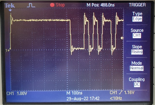

I probed TX_D0 and RX_D0 signals and I got waves like:
TX_D0 (1V per an interval of column and 100ns per an interval of row) :
RX_D0 (1V per an interval of column and 100ns per an interval of row) :
Could you check the approximate form is alright in view of signal integrity?
My MCU couldn't receive the data in my case.
Thanks.

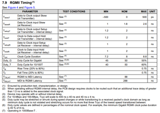

I cannot diagnose a raw waveform. You will need to perform a measurement on the oscilloscope and ensure it is meeting the specifications listed in section 7 of the datasheet. Which MAC interface are you using?

Hi GukHyun,
In that case, please perform measurements on the oscilloscope to ensure the following specifications are met.
