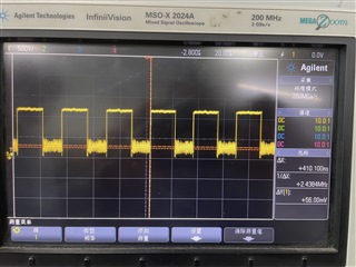

    After the configuration is complete, the waveform of MIPI CLK can now be measured, but the waveform of MIPI DATA does not look right. Figure 1 is the input MIPI DATA waveform of the 935 terminal. Figure 2 is the output MIPI DATA waveform of the 954 terminal.
    After the SOC receives these MIPI signals, it cannot output images.
    Figure 1
    Figure 1
    Figure 2
  • WriteI2C(0x20,0x00)
    In your application, are you connecting two 935 serializers to each RX Port on the 954? The line above is enables both RX Port 0 and RX Port 1 on the deserializer, which is only used if you have two serializer connected to the 954.
    And is the portion of the signal that you are zoomed-in on the High-Speed Data portion of the video transmission?
    Are you able to enable PATGEN on the 954, to see if a similarly distorted video is being outputted on the 954 CSI-2 transmitter?

  • Thank you very much for the RAW 12 PATGEN you provided. By configuring PATGEN for 954, I found that there is a problem with the back-end decoder board. After replacing the back-end decoder board, the image output is normal. In addition, I tested the 0x20 register, and writing 0x00 or 0x20 has the same effect.
