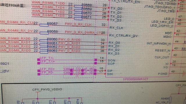

hi team:
 my customer want to use the DP83869HM to connect with the 4G communication module(use SerDes), but they feedback that it fail to ping/ connect for each other.
 now we are clear that both the DP83869 and 4G module are working well separately, and the connection pin as below B/D ,pin14/15/16/17.
 would you have to confirm how our device can be supported in this case?
 the data flow : MAC-RGMII-PHY- SerDes(RGMII) - 4G module.
