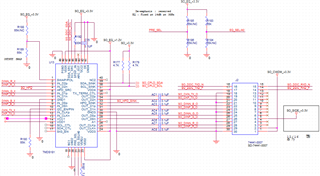

This is a question related to TMDS181.
I have configured the circuit using TMDS 181, and HPD HDCP works normally, but the TMDS channel does not seem to work.
I'm not sure if it's a circuit configuration mistake, so please check it.

I would tie SDA_CTL and SCL_CTL to 3.3V through 10k resistors.
But if you are AC coupling the TMDS181 output, then you would need to provide external 50ohm termination to 3.3V between the TMDS181 output and the AC coupling capacitor since HDMI is a DC-coupled 3.3V bus.

I am trying to drive without using I2C communication, but is the TMDS181 output only when the SDA_CTL and SCL_CTL pins are connected?
Is this an external 50ohm termination to 3.3 between the TMDS output and the AC coupling capacitor?
Even without I2C communication, I would still tie these two pins to a certain state since they are inputs. But tie them high does not impact the no output issue.
For the no output issue, you need 50ohm to 3.3V as you show in your schematic, and you need them on all data and clock output, both positive and negative.
The other thing is that the pullup on SDA_SNK and SCL_SNK need to be 2k per the HDMI spec, but this is a separate issue from the no output issue.
