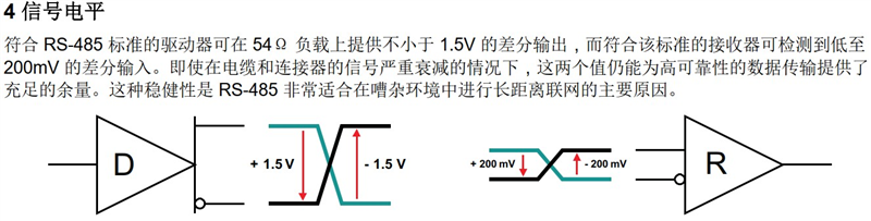

My customer has a question about the power consumption of RS485 while designing it.
Add pull high or pull low resistor will increase power consumption. If the Voc is 3.3V, then there will have 2V crossover the resistor.
Is there any solution of TI that can help customer? Or is there any method can make the PU/PD resistor will not increase the power consumption?
