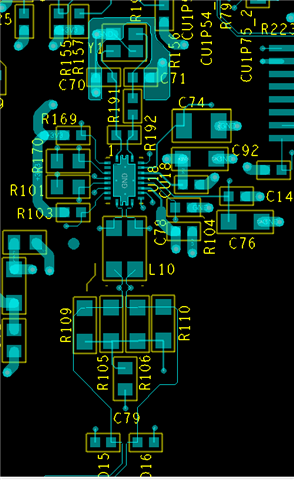

    I have quarry on Layout.  Please find the attached layout options that we are evaluating.  Can you please conform which may hold the best placement?
    Few important Highlights:-
    1. R105, 109 are 120 ohm in parallel (hence 60 ohm effectively) to improve the power of the resistors.
    2. R106, 110 are 120 ohm in parallel (hence 60 ohm effectively) to improve the power of the resistors.
    3. In Options1 it not possible to route the signal in 120 Ohm differential From L10 to connector as they are signal net and passing through the components.  Hence trace width and separation has to managed manually (Routing like differential).
    4. In Options2 it will be possible to maintain 120 Ohm differential routing.
    5. D15 and D16 will be moved near connectors.
     Please confirm on the same.(we tested and made working with Option 1)
    Option1
    Option2
  • Hi Basaveshwar,
    I think either option 1 or option 2 would work.  On our device evaluation boards we regularly split up the differential routing to single ended routing near the termination resistors, TVS diodes, and common mode choke.  When you do split the routing to single ended, you can change the trace width to a 60 ohm single-ended instead of the 120 ohm differential.  But realistically the impedance discontinuity of the component pads is still present.  Also, the total length of the discontinuities is very short compared to the entire CAN bus length, so either option should be fine.
    In looking at the crystal layout, I believe R191 should be moved to the OSC1 pin which is the Output of the Transimpedance Amplifier providing current to the crystal.  This series resistor is used to dampen the current flowing through the crystal and make sure the drive level (or power dissipation in the crystal) is not too large.  Also, the TCAN4550 has an internal 500k ohm feedback resistor between OSC1 and OSC2 pin so R192 is optional.
