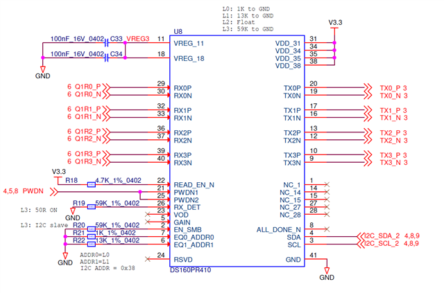

I need to disable the RX detection state machine via an I2C bus from an external controller and always enable 50-ohm termination. I tried to set bit 6 in register 0x0D - Manual override of rx_detect_p/n decision to always return valid. But the register 0x01 showed that the rx is not detected. I tried to reset the rx detection state machine by setting and resetting bit 3 in register 0x0D, but it did not help. I tried to set bit 5 in register 0x06 and it helped. The register 0x01 showed that both pins detected the receiver termination. My question is if I enable overrides for driver and equalizer enables by setting bit 5 in register 0x06, how to set up other bits to enable normal operation? I only need to disable the rx detection. The CTLE index may change during operation from 0 to 15. Do I need to enable CTLE Termination bit 6 in register 0x04, Enable CTLE bit 3 in register 0x04, Enable Pre-driver bit 4 in register 0x06, Enable Driver bit 3 in register 0x06 and Enable CM Loop bit 2 in register 0x06? What is the CM loop?

    1). Reg 0x01[7:6] are mainly used for PCIe RX detect status. Suggestion is to put the device in 50-ohm non-PCIe mode forcing pin RX_DET pin 26 in L3 mode. This would enable termination both on the output and the input of the channel. RX detect pin setting has priority over register settings. You should observe increased current consumption once this goes into effect.

  • Hi Nasser,
    1. We have a 59K resitor on pin 26 RX_DET - see schematic below. But Reg 0x01[7:6]="00" without additional configuration.
    It might be difficult to check power consumption by soldering and desoldering the resitor.
    In the manual mode (reg 0x06[5]=1), the Reg 0x01[7:6] shows "11".
    2. We tested with the following settings: reg 0x04=0x5F, reg 0x06=0xFC. With these settings, reg 0x01[7:6}="11" and does not depend on bits 6 and 3 in reg 0x0D.

  • Hi Igor,
    1). With RX_DET pin 26 at L3, this disables PCIe RX detection process. Reg 0x01[7:6] are mainly used for PCIe RX detect status monitoring not for non-PCIe applications. Please note by forcing pin 26 to L3, we have input and output termination. Otherwise this means we have a device/pin malfunction. Please just make sure you have L3 mode and you can be assured 100% that there is termination - otherwise device is faulty.
    2). Please note #1 above.
    3). Sure please go ahead and set these. These enable the output drivers. Note reg 0x06[5] need to be on as well for these to go into effect. We need to set reg 0x06[4:3]= "11" because normally PCIe RX detect state machine would turn these bits on internally AFTER it has detected a termination. But here you are manually controlling termination through pin 26. In this case, you are in manual termination mode versus PCIe mode.
