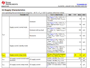

    The sleep mode current is a characterized parameter and specified in the datasheet.

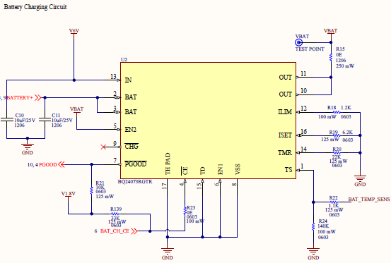

  • Hi Jonathan,
    We are measuring current in 6V path line which is going to only CAN & Battery charger section attached images for reference.
          Standby mode - 2.6mA
          Sleep mode      -2.3mA
    After removing R28(VCCIO is removed in CAN)
          Standby mode - 1.67mA
          Sleep mode      -2.3mA
    - >Battery charger was consuming 0.85mA.
    ->Removed input 6V supply for battery charger . CAN IC alone current consumption as below.
          Standby mode - 0.95mA
          Sleep mode      -1.21mA
    Note: After 4 minutes we not getting 5V at VCCOUT pin so consider that as sleep mode.               

    I'm a bit confused by your results that show the current in Standby mode is less than the current in Sleep Mode.  This should never be the case.  Just one of many reasons this is the case is that the VCCOUT (5V LDO) is ON in Standby mode, and OFF in Sleep mode.  Even without a load on VCCOUT, the voltage drop in the LDO would create a larger current draw in Standby mode.
    I see the VIO is connected to VCCOUT and also goes to a port called VCAN.  What is connected to VCAN and could it be drawing current?
    The device's Sleep Mode current spec states that the SPI bus, OSC/CLKIN be disabled which is done by VIO = 0V.

    What is connected to the nWKRQ pin and the CAN_WKRQ port?  When the device enters Sleep Mode, the nWKRQ pin drives high to approximately 3.6V.  If there is a load on this pin, it could add to the current draw in Sleep Mode.
    I didn't really see anything else from the schematic that looked like it would be drawing additional current.
