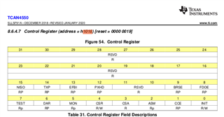

I am testing CANFD. Sending 64 data bytes at regular speed is blocking the CAN bus. I want to turn on bit rate switching by writing 9th bit of the register h1018. But 9th bit is READ WRITE PROTECTED type. So I am not able to write this bit to high for enabling bit rate switching for transmission enabled. What is the solution for this?
Below is the snapshot for the same.

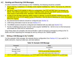

    The procedure for setting the BRS bit is outlined in the TCAN455x Software User's Guide and if you haven't read through this, it is a good resource to review.  The images I'm sharing in this post come from this document.
    But basically you can only change the "write protected" configuration bits when the device is in the "Initialization (INIT) Mode" which occurs when the INIT bit of the Control register (0x1018) is set to 1.  You also need to set the Configuration Change Enable (CCE) bit to 1 to allow these bits to be set.  However, in order for it to be set, the INIT bit has to already be set to 1.  Therefore if you need to set both the CCE and INIT bits to 1, this may take multiple writes to the Control register to allow the INIT bit to get set to 1, and then a second write will let the CCE bit to get set to 1.  Then once the CCE bit is set to 1, all write protected bits can be set including the BRSE and FDOE (FD Operation Enable) bits.  The FDOE bit also needs to be set to allow CAN FD mode in order for the bit rate switch to occur.
    Just setting the FDOE and BRSE bits in the Control Register will not necessarily cause all CAN FD messages to be transmitted in the FD format with Bit rate switch.  These bits just allow messages in that format to be transmitted.
    The FDF and BRS bits in the TX FIFO/Buffer Element header will also need to be set to 1 in order for that message to be transmitted in FD format with Bit rate switch.
    Jonathan

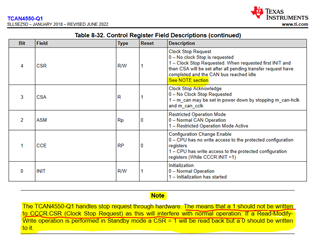

    Once CSR Bit is set the device turns to standby mode. But according to the instruction it has to be cleared but when I try to clear the CSR bit, It is not happening. As per the instruction from the user guide it has to be cleared. Could you please let us know what has to be done?
    Akshay
  • Hi Akshay,
    The CSR bit should not be written to the device through SPI and issuing a Clock Stop Request is used to prepare the device for Power Down or Sleep Mode.  This stops the clock and will disrupt the normal operation of the device.  The datasheet notes that the CSR bit must always have a '0' written to this bit when doing a SPI Write to set other bits.
    The solution is to not set this bit to '1' and allow the device to internally handle this internally.  The MCU application code should not need to ever set this bit and a '0' should always be written to this bit.  The note is to inform the user that the Read-back value will be a '1' and therefore a normal Read-Write-Modify function will need a special capability to ensure that a '0' is always written to this bit.
    Resetting or power cycling the device would likely be required to recover from a situation where this bit was set by the MCU.
    The TCAN4550 uses the "M_CAN" CAN FD Controller IP developed by Bosch.  Additional information about the CAN FD controller and register settings can be found in M_CAN User's Manual on Bosch's website.
    The register addresses are the same with the one exception that an offset of 0x1000 is added to each address in the TCAN4550.  Therefore the MCAN address of the Control Register 0x18 is the same as the TCAN4550 address of 0x1018.

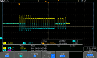

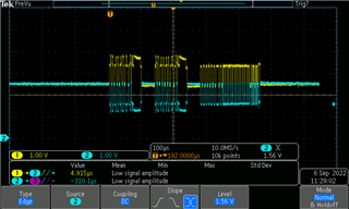

    1) Test Configuration & Issue Observed:
    • 2TCU's are connected to the PCAN. PCAN is the transmitter and one of the TCU1 is receiving the data which is sent by PCAN tool. In TCU2 the CANFD is not initialized.
    • When PCAN tool is transmitting the data frame with BRS bit enabled, the TCU1 is receiving the CANFD frame. But in this condition when we initialize the CANFD in TCU2 the error frames are getting generated and it is observed in the PCAN tool.
    • But if we perform the same above scenario with BRS bit disabled in the PCAN tool, then we are not observing the error frames in the PCAN tool.
    • Snapshot taken from CRO of error frame with BRS bit is given below:
    • Snapshot taken from CRO without BRS bit is given below:

  • Hi Akshay,
    1.) All notes on the bus should have the same settings and features enabled.  If a CAN FD frame is transmitted on the bus, ALL nodes must have FD enabled, otherwise the node that does not have FD enabled will throw and Error Frame on the message.
    Likewise, if the FD message is transmitted with a faster Data rate, ALL nodes must have the BRSE, or equivalent Bit Rate Switch setting enabled and must have the same Data Bit Timing settings.  Otherwise, the node that does not have the BRSE enabled or has different Data Bit Timing settings will throw an error frame on the message.
    Because error frames are generated when you have nodes trying to communicate with different configurations shows the system is working as intended during this test based on the CAN FD protocol and standards.
    2.) Based on the question I'm assuming you are referring to the TCAN4x5x Linux Driver.  This is a device support forum and I am not sure exactly when the driver transitions the TCAN4550 device from Standby Mode to Normal Mode.  However, the TCAN4550 always powers up into Standby Mode.  It will only transition to Normal Mode from Standby Mode when the processor sets the MODE_SEL bits in the Modes of Operation and Pin Configuration Register 0x0800[7:6] to Normal Mode (2'b10).
    The BRS error is due to not all nodes on the CAN bus having the same settings that allow them to handle CAN FD messages with a faster data rate than the arbitration rate.
    The error frames are generated at the device level because the CAN FD protocol is being violated with incompatible settings for the different nodes on the bus.
    3.) The thread you are referencing was assigned to another engineer, but I just read the thread.  TI is engaged with a 3rd party to improve the TCAN4x5x Linux Driver by optimizing the SPI communication to remove idle time and improve the data bandwidth.  This driver update is not intended to address the issues you are facing.
    To resolve error frames getting generated when the TCAN4550 is transitioned to Normal Mode, you must first ensure that both the BRSE and FDOE bits in the Control register 0x1018[9:8] are set to "1" and also ensure that both the Nominal (arbitration) Bit Timings (register 0x101C)_and Data Bit Timings (register 0x100C) are configured to the same values as the other nodes on the bus as I've just explained.  If these settings do not match the other nodes on the bus, error frames will get generated.
    Note, that devices configured to support CAN FD messages with Bit Rate Switching will not throw error frames on classical CAN messages (non-FD messages) and also on CAN FD messages that do not use Bit Rate Switching because the message header specifically instructs the node on whether the message is non-FD, FD, and or has BRS enabled.
    Therefore, for FD operation you should enable the BRSE and FDOE bits and set the NBTP and DBTP timing values for the appropriate data rates used on the bus.  This should prevent your errors when switching the device to Normal mode.
