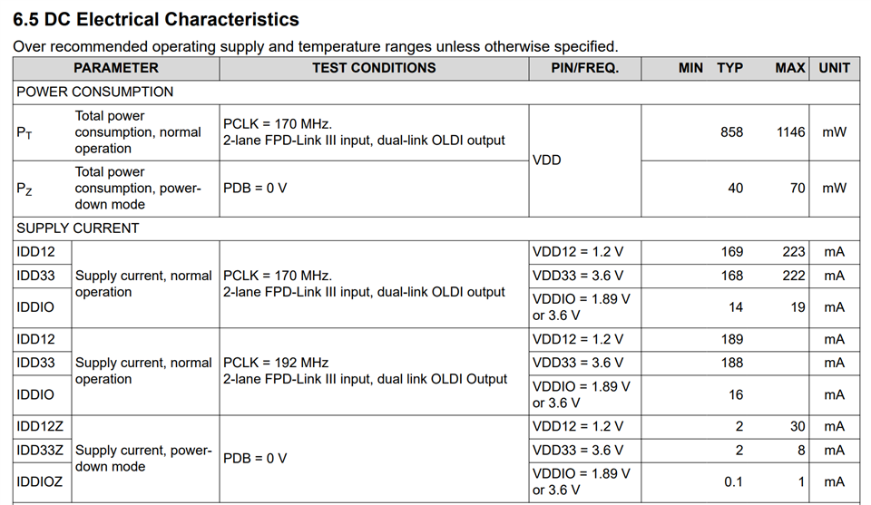

How to calculate the power dissipation for this part?
is there have max rating for power dissipation?

The maximum power consumption is listed in the datasheet here:

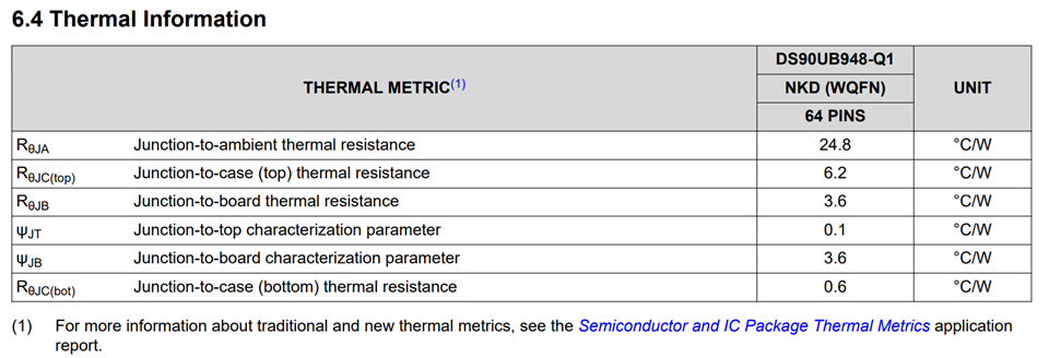

There is also thermal information here:
