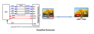

    I am not sure if I fully understand your question. The AUX and HPD are implemented outside the DP141 as shown in this simplified block diagram.
    Are you trying to Hi-Z the AUX and HPD pin on the source side? If this is the case, then DisplayPort will not work since both AUX and HPD are required.

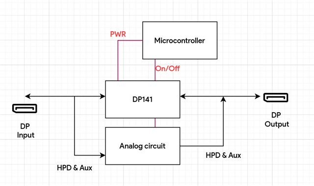

  • Sorry, let me clarify. I will use another controller to assert PWR and Hi-Z the aux and hpd when not needed. During normal operation, aux and hpd shall not be interrupted. I would have additional circuit to take care of that.
    Can you share a block diagram of what you are trying to do? I want to make sure there is no misunderstanding here.
    David
  • I hope this clarifies what I'm trying to do. PWR that goes to DP141 and the control signal that goes to the analog circuit which switches HPD&Aux shall be triggered at the same time when i want the downstream device to be disconnected.
    If you Hi-Z the AUX and HPD when not needed, it will be seen by the source and the sink as a disconnect or unplug event. In this case, it really doesn't matter whether PWR is being driven high or low.
    But back to the normal operation, you want to make sure the DP141 is out of the power down mode first before enabling the HPD and AUX.
