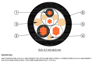

The cable is a single twisted pair with a ~100Ohm characteristic impedance, 0.22mm^2/24AWG area.
At 625m I get the following results (open ended cable):

  • It is a custom hybrid cable with one twistede pair used for SPE. Resistance is 92.4 Ohms/km, impedance is ~100 Ohms (Theoretical Impedance 102 Ohm,  Delay 0.129 ns/in, Inductance 13.2 nH/in, Capacitance 1.27 pF/in)

    Thank you for your reply. The twisted pair in our cable meets electrical characteristics of a CAT6/CAT5e cable (DC-loop-resistance=0.1848Ω/m, impedance=102Ω, delay=5.08nS/m, inductance=519.8uH/m, capacitance=50pF/m, wire-diameter=0.53mm, cross-talk doesn't apply - only single pair, etc..).
