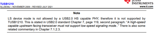

We would like to confirm from you about the device TUSB1210, from the top of page 18 D/S:
It says low-speed is not supported, correct?
Currently, my customer is using this PHY chip, both HS and FS is working fine. However, they can't switch to low-speed, and I came across the note I am asking.
For your confirmation.
Thank you.
