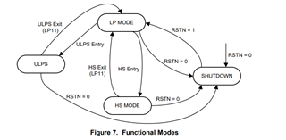

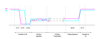

    1. The block diagram below shows the DPHY440 functional mode. To transition from LP to HS mode, you need to have the sequence LP-11, LP-01, LP-00. Are you seeing this sequence on the scope?
    2. Are you doing MIPI DSI or CSI? DPHY440’s LP TX is expecting to connect to an unterminated LP RX.  With Lane 0 path (DA0P/N and DB0P/N) supporting bi-directional LP signaling, it is very important that DB0P/N LP TX is connected to an unterminated LP RX.  If DB0P/N LP TX is connected to a HS RX, then LP signaling will not be able to reach the LP11 levels and which will cause the DPHY440 to not enable HS data path on Lane0.

    This goes back to my first bullet.
    The Omni sensor needs to drive the sequence LP-11, LP-01, LP-00 in order to go from LP to HS mode. Right now, it looks like it is just at LP-11 state (both P and N are 1.2V).
