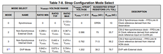

Looking for a approved resistor value for this non synchronous External clock resistor settings. Thanks in advance for the input.

Thank you for your question. To strap the device for non synchronous external clock mode, use resistor values of 75 kohm and 35.7 kohm. Place these resistors in a voltage divider, as shown below, with the 75 kohm resistor as Rhigh.
