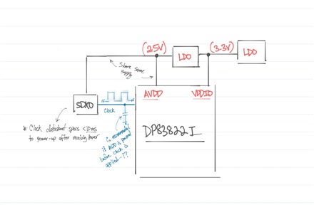

  • Hi Gerome,
    I attatched the use-case below. Specifically...
    1) 3.3V is generated and provided to VDDIO
    2) After the 3.3V rail is up it powers an LDO to generate 2.5V
    3) This 2.5V goes to both AVDD and the clock; so they receive power at the same time
    4) The clock datasheet guarantees it will power-up within 10[ms] of 2.5V rail ramping.
    In this use-case, are the timings described in Table 7-7 and Figure 7-2 for an "unstable" XI clock required?
    Basically, if the clock is starting after AVDD then RESET needs to be toggled according to desribed timings, yes?
    If so, then because the device is held in RESET during all the power-ups / clock starting, the recomendation for the extra 15~30pF of load capacitance on XI goes away?
    LVCMOS clocks are spec'd for Tr/Tf at certain load capacitances. CL = 5pF is typical.
    What would need to be the Tr/Tf requirements and the CL measurement capabilities of the clock to support this DP83822 requirement?
  • Hi Darren,
    In this situation, the capacitors are not a must have, but the reset will be needed.
    Sincerely,
    Gerome
