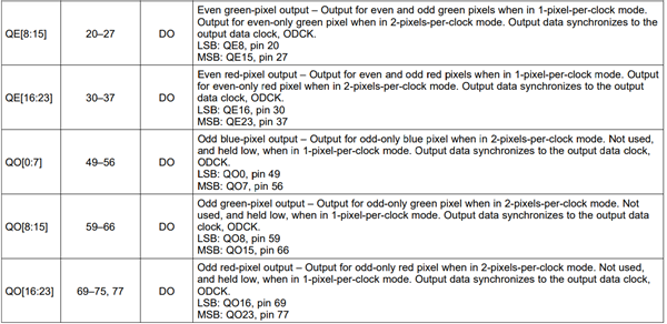

Part Number: TFP401A
May I know what is the different betwwen the QO0~23 pin and QE0~23?
I only find datasheet said one for Even pixel output, and one for Odd pixel output, does there have any relative document to explain that?

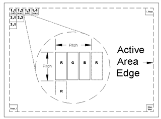

It defines how the pixel data being presented on a display. In the example below, first pixel at the top left corner is an odd pixel, follow by an even pixel...
