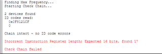

Hi Team,
Do we have an updated BDSL file? A customer is using the BDSL file from this thread but when they try to setup and test their JTAG chain with this device in the chain, the chain fails due to an inconsistency with the instruction register length.
The error is encountered when using XJTAG for the JTAG chain setup and control. There are 2 devices in the chain, the ethernet phy and a Polarfire FPGA. They tried to remove the phy from the chain and the JTAG chain works correctly and concluded that the issue is with the BDSL.
I am hoping you can help.
