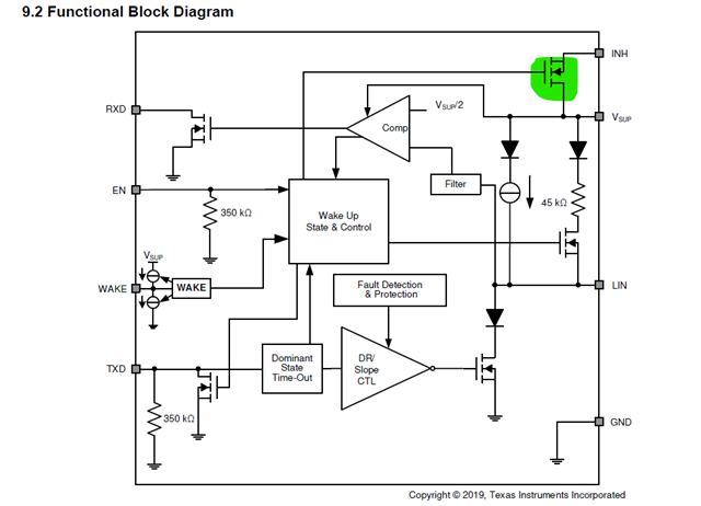

Hello Team,
do we have a resistor value of the open drain resistor (Drain/Source) at INH pin when in OFF state. (high impedance) ?
Would be helpful to calculate the quiescent current of the system.
Many Thanks

Hi Josef,
I don't think we'd have any specific number to give you when this FET is high impedance, but maybe I can help with the estimate your customer is trying to accomplish?
When you mention quiescent current consumption, are you asking about quiescent current consumption of the TLIN1021A-Q1? This isn't really impacted by this FET.
Or, do you possibly mean current in the pin when the FET is off (sleep mode)? This would be ILKG(INH), which is spec'd to an absolute value no larger than 0.5 μA.
