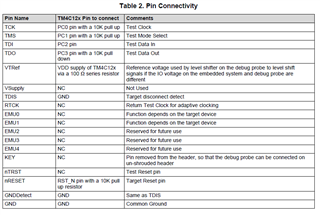

Pin named nRESET in XDS110 Debugger needs to connect port named RESET in TM4C129x.
And 'RST_N pin with a 10K pull up resistor' mean I can connect it to the 3.3 V supply voltage rail through a 10KΩ resistor?
Isn't it OK?

That is OK.
